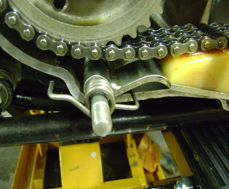

(1981 Ironhead fresh build) I have a knocking sound coming from the front of my primary at idle. In gear when riding, it doesn't get louder, but is mostly noticeable at an idle. I took the primary off and am wondering what the sound might be.
My manual isn't very clear on the chain tightening process. I tightened the spring adjuster nut on the outside of the case, but it didn't do much.
Any suggestions? All looks to be tight and clearances seem ok inside the case.

A tiny movement of that adjuster and you can see the primary chain move. If you adjusted the primary chain adjuster on the bottom of the case with no effect then the adjuster mechanism is broken. Post some pics of the inside of the primary case, especially of the adjuster mechanism.
When mine broke i had steel pieces in there. Fortunately they stayed on the bottom.

If you can't see some kind of marks where the chain has been hitting the case try and move the chain up and down by hand. It should only have 3/4 " movement. If that's all it has you might be in trouble. I say that because there's more than one reason for a knocking noise at idle and the second one is what I call, in technical terms "Not Good".

It has more movement than 3/4", and there is some marks from where the chain is hitting the case below the front of the clutch basket.
Is the only chain adjustment that bolt/nut that sticks out of the case? Motor is a 1981

Let me also clarify that the motor has a fresh build and was never knocking before. This seems to have started after I took the basket off and installed a new clutch cable, thats why Im thinking I may have the chain out of adjustment.
The shifter rod seems to have quite a bit of slop in it, but not sure that means anything.

yes that is the only adjustment for the chain.how much of the stud is sticking out of the case? it is possible the shoe has come off looks like at the very least you might have to pull the primary again.

Pic of the primary with shoe removed.
Also: is the tensioner spring located correctly?

how long is your adjuster bolt someone may have lost the original and replaced it with the wrong length.

slop in your shifter... don't know what kind of slop your talking about but make sure there is a brass bushing in the primary cover behind your seal for the shaft it can slip out sometimes.

Brass bushing is there.
Where Im having problems tightening the chain is here in my manual.
1977-1985
1. Remove primary cover (check)
2. rotate chain till tightest point is halfway between... (check)
3. lift chain with finger to check free play (check)
4. (heres where it loses me)
a. Loosen chain adjuster locknut. (didn't I do that to remove the cover?)
b. Move shoe support up or down to adjust chain free play.
c. Tighten chain adjuster locknut?? and recheck the adjustment.
d. Reinstall access cover..
It all makes sense, but is there supposed to be a chain adjuster locknut inside the case? The only nut on the bolt that holds the shoe on is located outside of the primary case and would need to be tightened after putting the primary case back on.
Am I missing something here?
