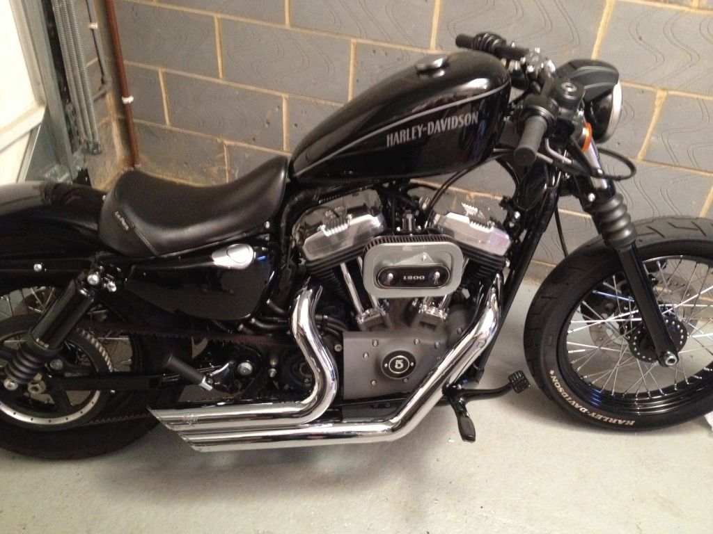

Hello guys. I know there are numerous threads on this but I have not found a definitive answer.
I am wondering what exactly defines the stage 1 filter simply.
I have the k&n replacement air cleaner element on my sporty and I run it without the ham can (have run in very heavy UK rain many times without an issue) and the original but cut down backing plate which I will post a photo of. Now looking at the surface area of my filter and the surface area of the well know joker machine air filter element I cannot see how the joker machine could provide any better airflow to the stock engine than my home made job.
I would like to be proven wrong so I could justify the cost of the other 'stage 1' filters.
Out of precaution and for your info I added a fuel controller to my bike to add more fuel as I have short shots also. The bike really runs great and pulls brilliantly, a vast improvement over how this bike was when I rode it from the dealership.
So really the question is what is the difference between my filter element and other more rather expensive options. I know some of the other filters have larger elements which are wider etc but how much different does this make considering the stock motor can only pull in so much air???
Any answers or comments, negative or positive on my own set up are greatly appreciated as I am new and exploring my bike and it options with looks and performance.
Cheers
Here is a photo

personally i think you pay for the brand tbh. most open filters of a similar size i would have thought flow the same you just pay more for the brand . i think i read somewhere on here that some filters can restrict flow but thats only in high bhp motors i think.

Yes and no. I personally looked for one that specifically used a K&N air filter. The filter alone is going to flow more CFM's than a stock filter. Then you have different venturi's that flow the air into the intake manifold. NRHS or Hammer Performance is probably the best known for this as they use a nicely made metal one (billet) plus they use a K&N element. After all that is said and done you can choose one like the previous two mentioned that route the crank case breathers outside instead of back into the engine (Resulting in an even larger performance gain). I chose the Joker one because it used a K&N and I liked the looks. If I wanted even more performance I would have went with NRHS or Hammer.

IMO. Stage 1 = anything better flowing than the stock paper filter with crappy plastic back plate and small opening in the front.
There are many good after market designs like the Hammer air filter that have built in venturi ridges.
K & N oiled filters seem like the prefered choice for the element and it's also a good idea to not suck in the breather oil mist, although some like the Arlen Ness Big Suckers do and are considered Stage 1 filters.

Thanks for the replies guys, out of interest would I see a noticeable gain running an NRHS filter which vents the breathers outside the filter as opposed to my current set up or is this as above mentioned really only a benefit for high bhp motors?
Don't get me wrong the aftermarket cleaners look real nice but I try to be different where I can but still like to maximise performance aswell without dropping $$$$ on motor upgraded like cams etc etc.
So we think I'm getting about the maximum amount of air which is usable by the stock motor? Well I guess the question is, am I at stage 1 or would we say stage 0.75?

Honestly, I Doubt it. Once you get the engine breathing by changing or just modifying the stock airbox, Theres not a lot more gain to be had by increasing the air. What i mean is Yea one Air Cleaner may be capable of flowing 2% more air than another but that doesn't mean anything unless the current setup is restricting the flow. Once you open up the intake the engine is getting all the air it needs for the stock heads and cams etc...So dont spend money on the claims of HP to be had. Focus on whatever is currently limiting the power......
Choose the air cleaner setup you like and then move on.......

I believe that once you go inside the engine for ANY modifications you are STAGE II
Now do we have different Stage I levels ?

Stage one is a better AC and better exhaust= tax paid.

Plus a some kind of fuel management system.

Mmm, ok guys so I guess I'm ready to wear my stage one badge as I don't fancy the looks id get if I wore the new stage 0.75 badge
I've achieved the stage 1 at a cost of £150 short shots, £125 dobeck fueller and 99p for my brand new K&N filter (eBay is great!) No labour cost as all self installed.
Total £276 for mine ($444)
It would be interesting to find out the cheapest stage 1 ever and also the most expensive... Listing parts and cost inc labour..
