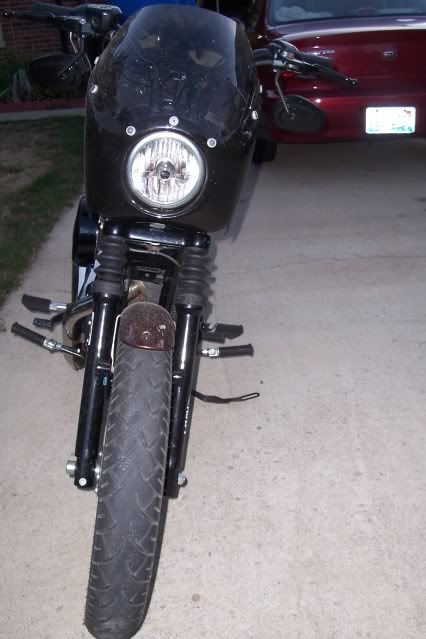

I appreciate that. I understand the way you like it. I grew up in one of the areas SOA bitt their style from and this is what I like. Most of them run taller risers but it make my shoulders hurt so I'm stuck at 8.5. I still liked the style and wanted a taller fairing. The mad max deal put all the wind into my helmet. I run a full face so it was annoying, switching to taller puts it above my helmet.
Originally Posted by 041200r View Post
Please explain how you "lifted it". Maybe some pictures. Thanks
No pics needed. I had the Arlen ness relo block, really only lifts it an inch and moves it forward two inches. I removed the bolt that comes through the bottom clamp. Replaced it with a 6" bolt, I put 4 one inch chrome spacers from Lowes over that bolt then the Arlen ness block ontop of that. Left me with ~5" of lift and ~2" of forward.

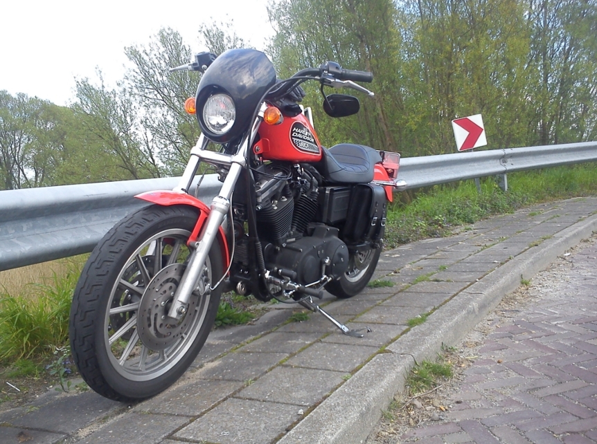

After my 1250 conversion I found myself rinding a lot faster all the time so I got this fairing. It really does help against the wind and I like the look too.
No idea how to fit this into the bobber style bike I had in mind when I bought it though

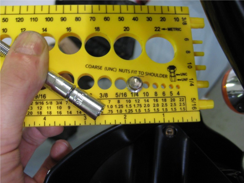

What size screw did you use on the 3 holes that mount the fairing to the mount? The one we have came with the "mounting hardware" but no screws to attach the damn fairing to the mount...

Hey Matthew,
My fairing came with the screws and i don't remember what size they were when I installed it. They might even be metric. Did you buy the fairing from China on ebay ?
I can check it for you if you can wait a few days.

Ok I did check it out for you today anyway. Have a bit of a sore back so I couldn't go training and I went for a ride instead
The screw is 1/4" and the head 5/16th.
The screw also fit in the M6 hole though so it might be that but I would get a 1/4 screw if I were you.
