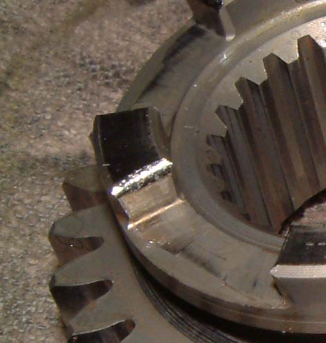

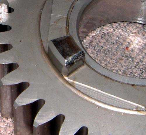

Here's what it looks like:
When the corners of the engagement dogs get worn like this, the transmission will jump out of gear (and generally back in) when you apply a load.
The parts aren't overly expensive, and in the older bikes it's not even a very big job to change them. But on a Blast or a Buell XB or a 2004-up Sportster it's a full motor tear-down.
