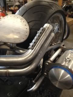

Originally Posted by mikedsilva View Post
Whats the ground clearance like with that pipe?
I'm planning on building a custom 2-1 exhaust. I will be using a BUB header paired with a custom reverse cone muffler from cone engineering.
Muffler:
My main reason for the custom pipe is to gain some right hand lean angle, I'm sick of dragging my pipes in right turns.
I do love the look, sound, and WOT performance of the Bassani's though.
I would also like to pick up a little more low-mid range power, the finished exhaust should look something like this, minus the upswept transition piece:
or this:
Hopefully I don't run into any reversion issues with this set-up...

These are mine. No ground clearance issues...
I used a heat shield from a Mossberg 500 shotgun for a heat shield. True shotgun pipes!

Looks like you'll be draggin' that oil bag though!
