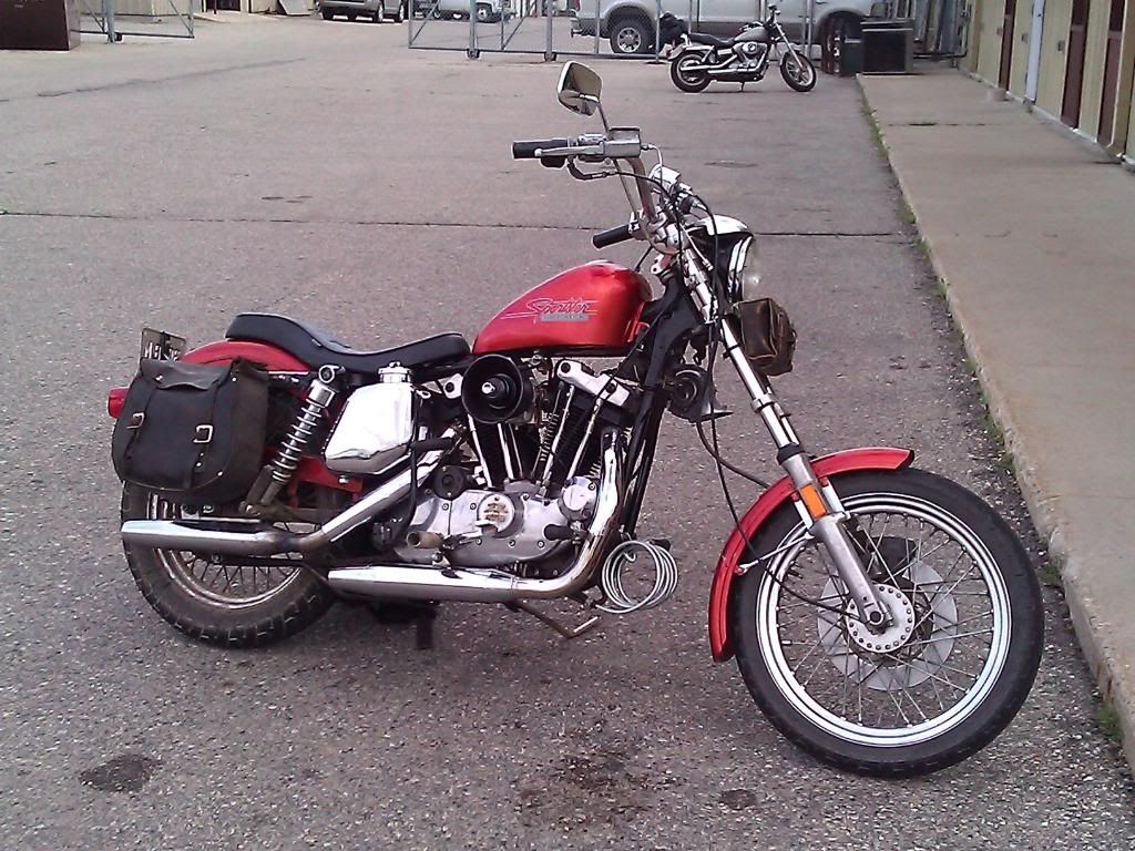

I was able to lower my bikes running temp 10 to 15 degree’s with this one I made out of 3/8” stainless tubing and a pipe bender. I intend on making a tighter one out of copper. The cooler was well worth it In my opinion.
