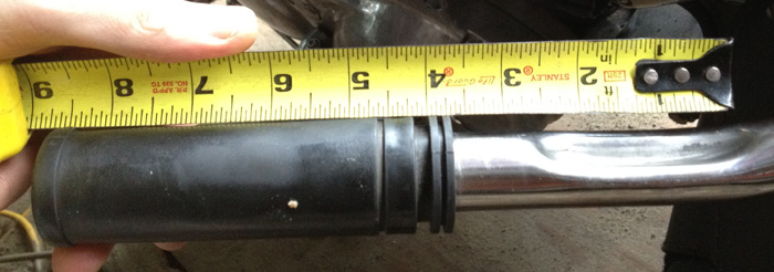

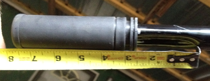

Finally settled on some beach bars for my bike.
When I started mounting back up the switch housings I couldn't get the wires to settle into the dimples.
I found the reason.
Harley bars have the dimples ending at 8 1/2" from the end of the bar.
The Drag Specialties bars stop at 7 1/2" from the end.
Too short for the wires to tuck under the sleeve mounts.
Any ideas of how I can extend the dimples 1" for the wire tuck?
Beach bar dimple length
Harley bar dimple length

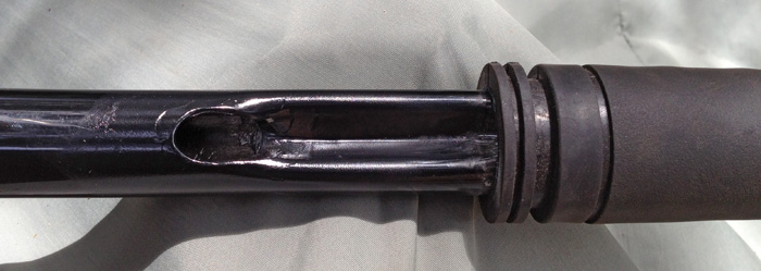

Put your controls on, mark a 3/8ths line out from the control body.
Pull control and drill (2) 1/4" holes along the line.
File the 2 holes into a slot shape and deburr, coat slot with plastic dip and you are good to go.

Great idea.
You got my mind away from the angle grinder.
I had also considered adding 1" to the end of the bars using 1" pipe

pros vs cons of notching the housing?

As long as you stay away from the wires and seal it up...i see no problem.

3/8" drill bit and a dremel tool to shape and smooth.
Painted, test fit and put together.

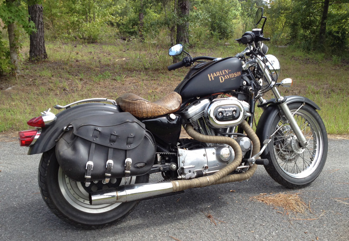

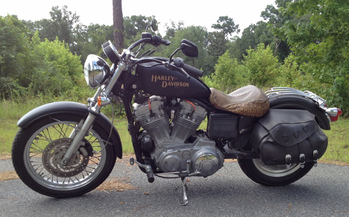

And a couple pics of the completed bike.

good job....
