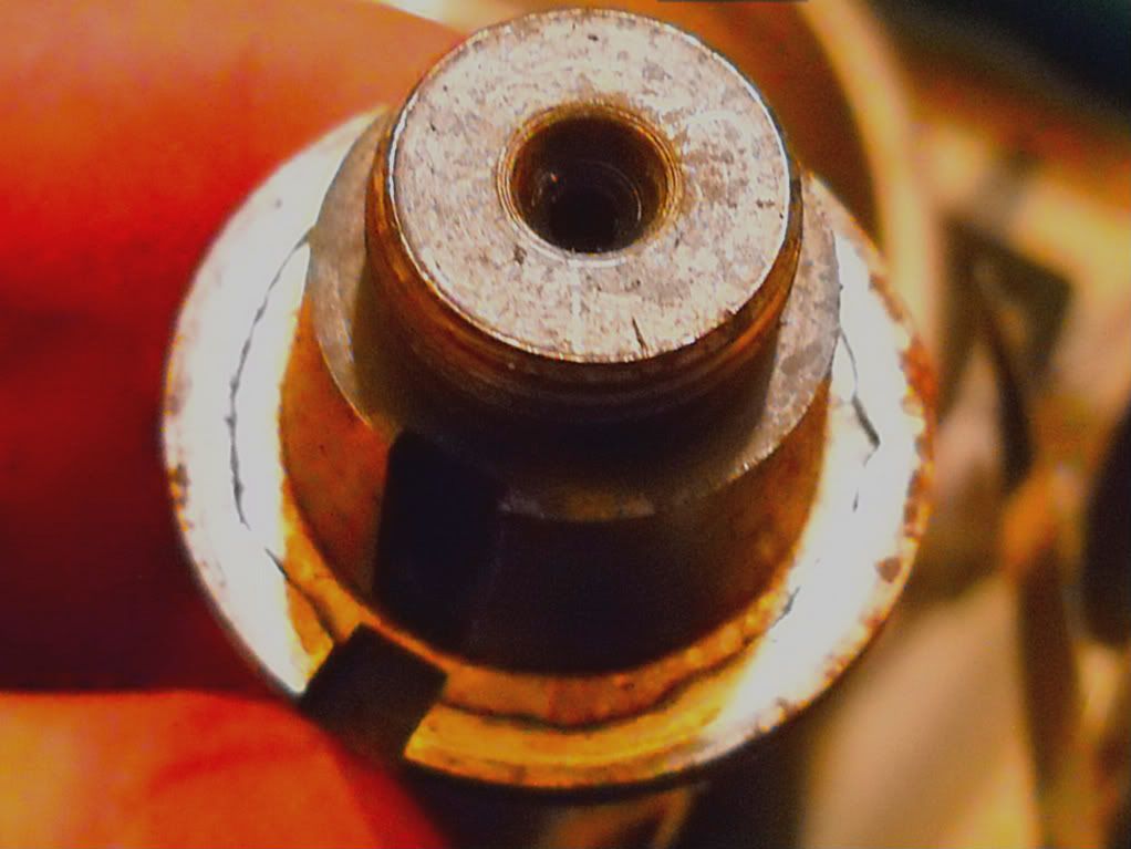

Default So you don't want to split those cases?
Used motors contain lots of surprises. This sprocket shaft came out of an 1980 motor that ran and had no issues. Split the cases if you have any doubt.$70.00 worth of gaskets and some effort,[ or enjoyment IMHO] may save you, and your motor. Besides the shaft, 2 cam cover bushings had the shoulders ground down to the cover. I don't like these kind of discoveries but I definitely don't like a bomb with the fuse lit between my legs!

OUCH! Good catch.

hcrashster
Wow I wish I had your confidence. I have been spending lots of time trying to diagnose a knock. Fixed the biggest one, loose fly weight on the timing advance. But there is still something there it's small but I still hear it. Just afraid to dismantle the whole thing and not find the problem. This may be the inspiration I need to just do it.

I remember your thread. Between this forum and your service manual you have all the info. you need to fix that knock. I remember thinking: You might have some problems there. The advance weights self destructing leading to full advance at all RPM ranges. As the spark fires way to early, { When the piston and rod are on the compression stroke } the entire rotating assembly is getting hammered. Remember the piston has to ascend to top dead center, then descend on the power stroke. Early spark forces piston and rod down while the flywheel, is thru rotation, forcing it up. Bearings don't survive this for long. Tear it down and look. Take pictures, write notes, and put parts, by assemblies, into marked plastic bags. Take it step by step. It really is fun, I mean it.

Sheesh! Glad you had the agates to go in. Its just a biiitch without the tools and experience to crack the cases. When you put her all together and the SOB is leaking or something and you have to go all the way back......well, Im sure thats where a lot of good Ironheads found new owners sitting all pretty in boxes
