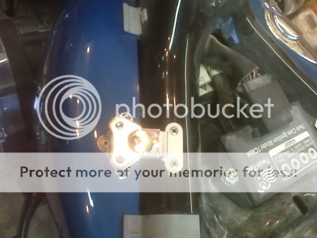

Even simpler I drilled a small hole for a 2/56 screw down through the plastic clip and through the slot in the cover 10 cents worth of screws from the hardware store and that cover will never fall off again and it closes the clips firmly also got the ideaoff another Harley forum

Mine is bolted on with 15x 1/2 inch bolts , oh yeah they are from a fighter jet canopy and have explosive charges in them which is wired to my horn button incase i need to access my battery really quickly.
