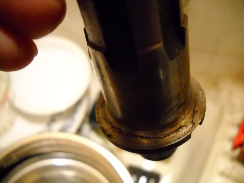

If your going to build the motor and have the money, it might be worth going the whole way. T&O or not. This is what I found on my last rebuild. A junk sprocket shaft with one foot in the grave. A couple of high RPM runs and the cases would have been boat anchors. Looking will cost you time and very little money.
I'd be more inclined to believe that crack is due to improper assembly by a previous owner since the only "forces" on that lip are from the compensator, or from the sprocket shaft bottoming out in the flywheel due to faulty factory machining (somewhat prevalent in late 70's models).

Lord knows, A lot of used Sportsters are like a box of CrackerJack with a Black Widow inside. Flywheel was tight with good bearings all the way around. A friend of mine who is a machinist put the shaft up on an optical comparator after it was washed with a penetrating dye. Along with the fracture at the shoulder, micro fractures were found the entire length and the general consensus was improper heat treating. If you remember in how bad a shape HD was in at that time, a junk part on the assembly line was probably common. I'm not 100% sure what the cause was here, neither were the machinists that inspected it. So you may be correct. I'm just glad I found it in time.
