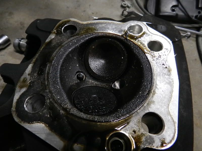

Originally Posted by rottenralph View Post
Is there a good example out there of what an unshrouded valve looks like? I am not quite sure why these valves are said to be shrouded.
Here's 62cc Lightning heads with NRHS stage II work with .040" decked and cc's is 64 now. With 10 degree 10.5-1 pistons, 575 cams and .050" head gasket compression is 190 on both cylinders. Going with a .030" headgasket compression is 15 psi more.
OP oem head

That picture does a great job of showing what a Lightning chamber needs.
What we need is a clean picture of a stock chamber to show how bad they are to start with.
