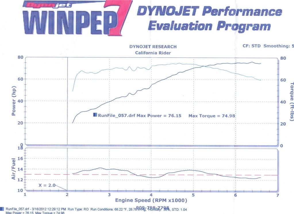

Default Rocketmans Dyno from 3 16 2012
I can tune a little too !
Big thanks to our "Map Guru" Rico the Roadster !
Thy Sportster Come
It Shall Be Done
On Earth as it is on Salt
2006 Sportster XL1200C
Mikuni HSR 45
Jetted 30 slow,175 Main
97 Needle,Clip posistion 3
Daytona Twin Tec TC88A,Rico Nomad Map
Patriot Defender Pipe
Royal Purple 20W50 MC oil
Wix 57148 oil filter
Max Power, 77.73
Max Torque, 75.98

Did the tuner offer you a 400$ tuning program offer?
76/75 is pretty good for a stage 1.

Jean
I have a CARB !
I tuned it with Ricos help !
We tuned nothing on the Dyno today
Ran it as I rode it in off the street

So I was right no 400$ tuning offer. Did The dyno operator try to rub off the 883 insert on your carb AC.

So Jean you are thinking perhaps this may not be a Stage I 883 ?
