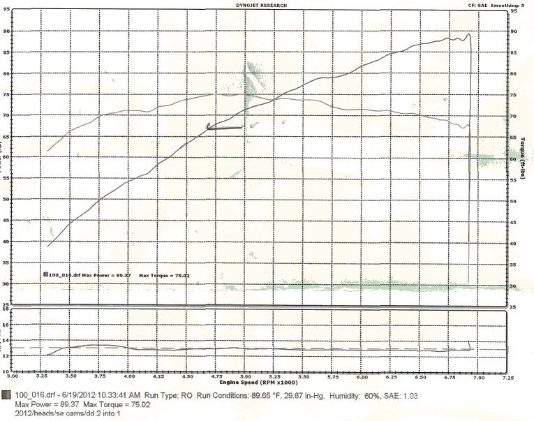

Default 2011 xl1200x
HD Heavy Breather - 29080-09
D&D Bobcat 2 into 1 - 563-31-32
NRHS Stage 2 light head work - 003-NRHS-STG2XL12LGT
SE cams .551 lift - 25197-04
Additional parts and list prices if you are interested:
HD Heavy Breather - 29080-09 $299.99
D&D Bobcat 2 into 1 - 563-31-32 $780.00
NRHS Stage 2 light head work - 003-NRHS-STG2XL12LGT $750.00
SE cams .551 lift - 25197-04 $355.00
Gasket top end - 17049-08 $124.00
Gasket case - 25263-90D $5.92
Exhaust Gasket - 17048-98 $10.50
Parts Total = $2,911.49

Nice chart rvgriff. That AFR line is one of the most consistent I have seen. What are you tuning with out of curiosity?

Must have a good tuner. That air fuel line is perfect. Great hp curve.

NICE ! And Austin is right, that AFR looks great

Screaming Eagle Super Tuner Pro was used.
For the life of me I can not find my bone stock chart to post but it was 62 HP and 73 TQ.
Same dyno and same person.

Your stock TQ was likely lower than 73, good job bud.

I sure hope so because I was wanting to see more in that department but that is what my mind recalls.
Guess the next mod will have to be a 90" conversion.....
I am the most impressed with Dan's fine work on the heads. That was the best money spent so far!

nice numbers good job.

Thanks Bob but I truly can not say enough about Dan's work on the heads! It is a completely different bike now and I am set up for more mods down the line.....like one of Jason's turbo kits!
