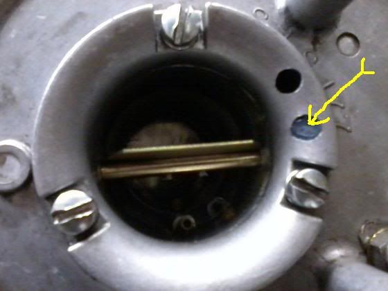

Heres a pic, the hole with the arrow is filled with silicone, right behind it is a vent hole that goes to the float bowl.

Just un plug the hole Looks like that plate was on a keihin then someone fitted it to a s+s and pluged the keihin hole

Thats on the keihin, but with the plate off, vent open, the idle mixture screw has to be out 3 to 3 1/2 turns to make it idle, with the plate on and the vent blocked off, i have it 2 1/2 turns out to make it idle. I put a .80 slow jet in it, that helped.

The open hole is for the s+s carb but you need the blocked hole un blocked and then set the idle mixture .And if you need the mixture out 3 to 31/2 turns out with the plate off unblokck the hole and put a bigger slow jet in you need that vent open with the plate on and the mixture screw should be out 2 to 2!/2 turns out max,If you have the screw out more than 2 to 21/2 turns out the slow jet is to small
