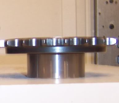

Sprockets use a longer front spacer than belt pulleys, but you can't "space" the front. It has to be at a certain place on the splined shaft. It should have offset depending on which way it is installed. If you run it flipped out, you'll need to use a straight edge to see what spacer you need for the rear. 1/16" washers between the sprocket and wheel work great to figure the spacer size.
This is a Renthal 520 front sprocket and Zipper's spacer.
