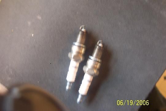

here are a pic of my plugs and was wondering what you think. i have a 45 and 2 1/2 turns on mixture and 180 main and no shims under the needle.i know a little fuzzy but the best i could do with the camera i have.hope ya can see it.

With the fuzziness, they look all right to me. It be better if we could get a clearer, closer picture though.

look clean, too clean maybe. hows the fuel mileage? farting,popping?

fuel about 54mpg and poping on deaccleration and ocassional carb fart and sat during a 100mile ride it died at a stop sighn.

What's the gap on the plugs set at???
maybe just richen it up a bit, just a bit.

If you have the ram-Flo and the turn outs shown in your gallery, I would suggest that you richen it up just a bit. Very hard to tell from the fuzzy photo. The 45 pilot is probably OK but the 180 main may need to go to a 185. Better pictures are really needed as well as stating which plug is from the front jug.

shim the needle and turn out screw 1/2 turn out, possibly 48 slow 180 main should be all you need.

just to add one more thing, if there is no running problem, i wouldnt do a thing. only if you suspect its not running right would i start messing with it.

Looks like medium gray/tan to me. Leave it alone, eh.
