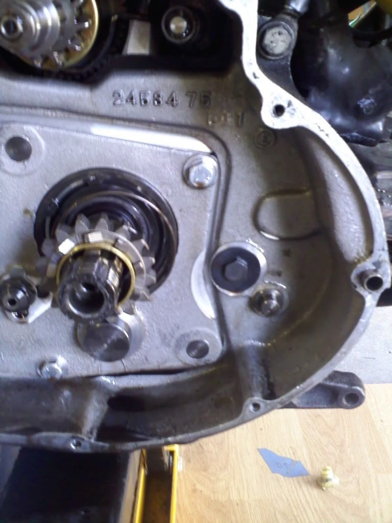

I know this is a old thread, but everyone talks about this.
I have a 1982 ironhead as well and had my starter realy die about 30 miles from home last weekend. A buddy pushed me up the next hill and i did a 2nd gear bump start...
Anyway, it got me thinking about how to convert my 1982 to a kicker.
I have installed MANY a kicker on older ironheads and actually have a complete 'backup' kicker kit sitting around that i have been comparting to my 1982...
If im not mistaken, the clutch basket on the 1982 WILL accept the ratchet plate.
The 'Serious Machining' everyone mentions seems to boil down to drilling a hole in the rear motor mount and the inside of the primary case in the engine block for the kicker shaft. Then the sprocket cover and rear brakes need to be converted to 1979 specs.
This does not seem difficult at all if you take the cases apart.
I just finished re-doing the bottom end and will not be splitting my cases again so soon, so am i crazy to think that i can lay the bike over on its primary side and true it to my drill press to get a good clean hole in the case?

so i'm thinking. . .the hole is what 3/4"? . . or around that, what sort of tolerance . .say less than 1mm . .too far away and your gears will not have a full mesh, too far in and it will all bind and lock up. . . . your going to have issues there unless your mighty lucky!!

I was once told by someone "not completely full of it" that basically that it. yes the hole location is critical but and good machine shop could do that one ( I dont know the definition of serious machine work but, after what I've been through with my guy this dont seem so well SERIOUS.. His was done by a dealership no less which had a wrench who had started in the AMF era. Soooo... even though I've been told "no it aint happening" the next time my cases are aprt I'm doin it. o yea E84

im not sure what the inside of your primary looks like on the newer ironheads, but here's my early 80 that had the hole in it for the kicker(which is now fitted) you can use this as a reference to see what you might have to do to get it to work on the newer bikes.
good luck with this adventure.
