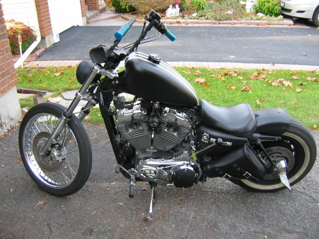

Originally Posted by Oli1200 View Post
This is really turning into a scientific discussion.
Nice scoot.
Did you leave the clutch cable hang on the pedal side? Can't see it in the pic. I have seen about 75% of them hanging and the rest solid mounted some way.

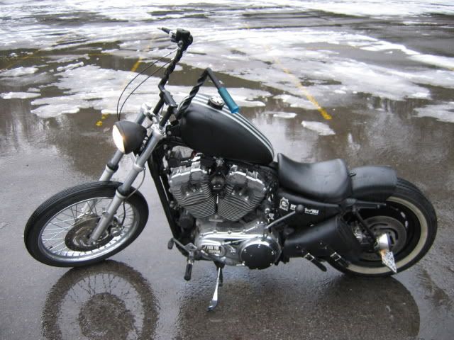

Mine is just the Labriola setup. Here's a better pic:
Here's a video I took of me dicking around in a parking lot playing with my camera:

Very cool.
Nice clean and simple setup. From the vid, it looks like the letoff isn't too bad either. I'm starting on changing the rake tonight and will do the jockey when I get that done.
