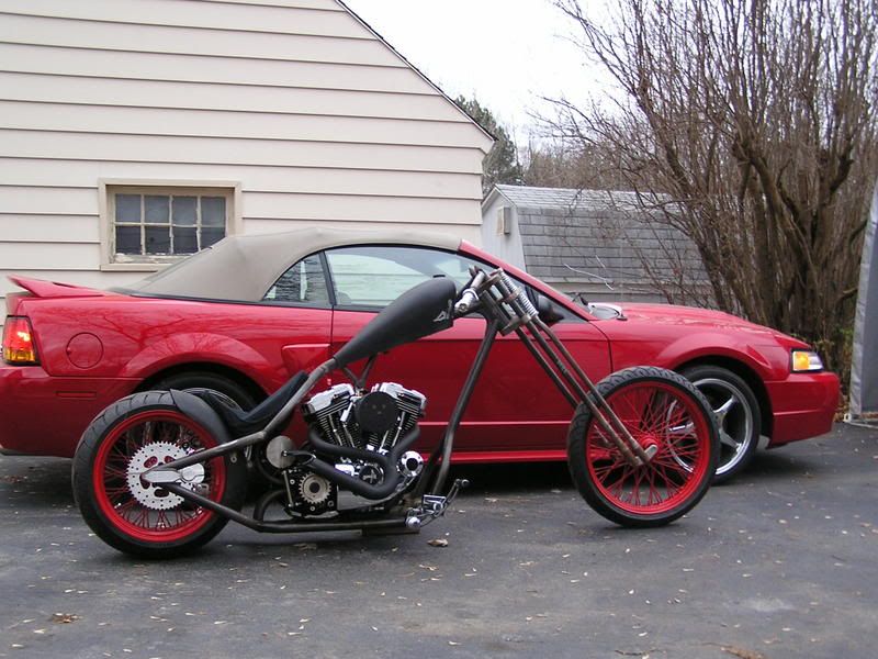

I'V BEEN THINKING ABOUT TAKING A SANDER TO THE FRAME AND SHEET METAL. TO GIVE IT THAT SHINY SWIRLING AFFECT. THAN HAVE MY TATTOO ARTIST DO SOME OLD SCHOOL HOT ROD PIN STRIPPING ON IT, BUT I'LL NEED TO KEEP IT FROM RUSTING. A REGULAR CLEAR WON'T ADHEAR TO BARE METAL SO ANYBODY KNOW WHAT I CAN USE??? ALSO TAKE A LOOK @ MY BIKE AND TELL ME IF YOU THINK THAT FINISH WOULD LOOK OK, OR LIKE POO.

Go to an automotive paint store and they can provide a treatment for bare metal that allows clear coat to stick to it. It comes in a rattle can.

Nice RE frame!!!!!!!!!! did they make the springer also? looks kewl as hell.

THANKS!! yes the springer is from redneck. hey Dennis is you can get me the name of that stuff it would be great.., no rush.thanks

What Jerry said. Nice sprocket/disc! Right leg might get a bit toasty at lights!

Sweet bike..Looks good as it is to me...
