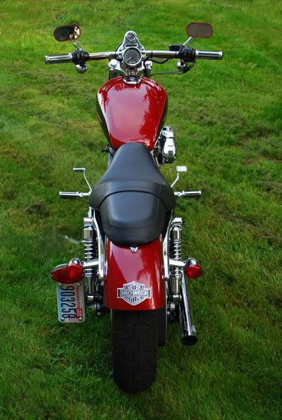

Thanks for the input, I'll give it a try and post a pic. Nice bike!!!! I like the color choice!!!
