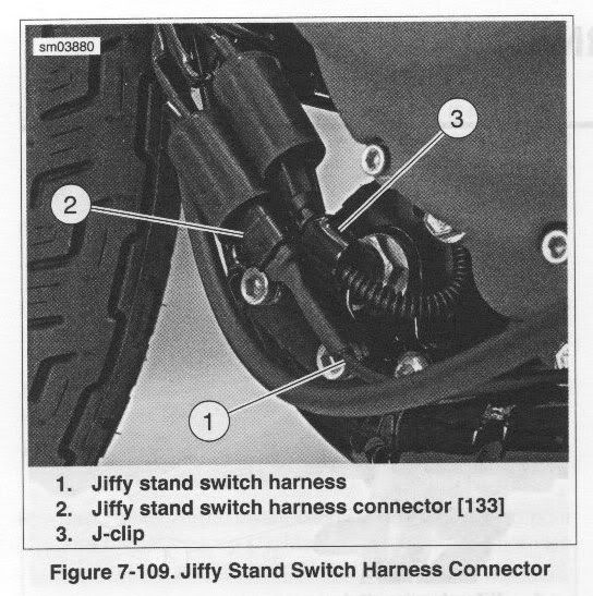

Kono - Do you means the starter rattled when trying to start it in one of those "unsafe" conditions?
Here's a picture from the manual on the wiring (thanks to Sportytrace for the picture):
