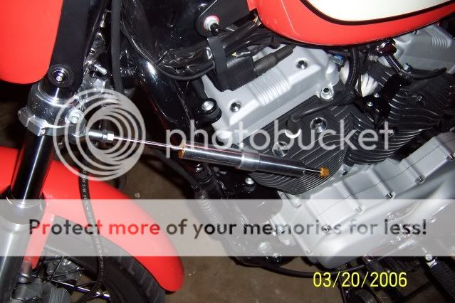

The total stroke will depend somewhat on how and where it's mounted.
Here's my Storz unit
beautiful
I found one used (price economic)
it is Ohlins with total stroke of 5,5118 inches
enough to mount?

Originally Posted by skizzetto View Post
beautiful
enough to mount?
ciauuu
That should be plenty...when you install it, just make sure you have some travel left at both extremes so you aren't bottoming it out!
