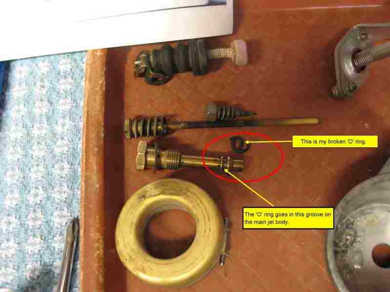

You want to make sure and look at the O ring around the main jet housing. See the pic..........
These things go bad and will give you much grief if they leak. If you need to replace the O ring just go to Lowe's and find a #5 or #6 O ring in the plumbing department. A 10 pack will cost you $1.29
