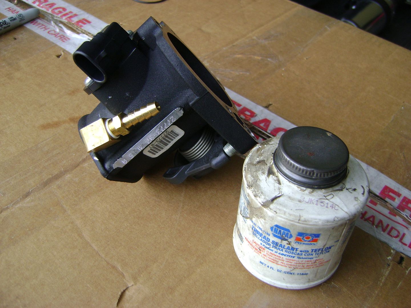

Here I prepare the throttle body for the 1/4" vacuum line fitting. First off a 1/8" starter hole...
Followed by a Ltr. R drill bit for the 1/8" NPT fitting...
Threading the previously drilled hole...
You may use a 1/4" drive ratchet with a 1/4 to 3/8 adapter as an alternative to a tap wrench...
I opted to use thread sealant w/teflon for these fittings...
Perfect!... much better photo than I sent you. Youre getting good with the camera, I need to practice now too
