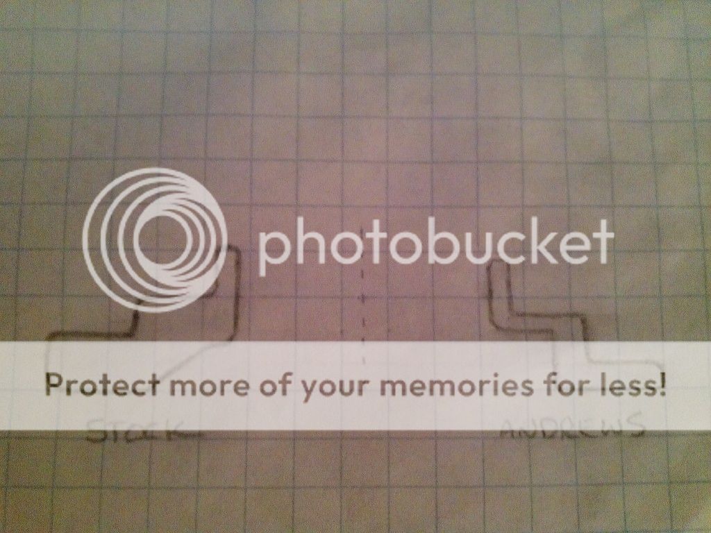

Here is scaled sketch and its worse than I thought, especially drawn next to the stock part.
If only Andrews incorporated some of that lower angle, like the stock one has it would make for a much stouter piece.
To make it even worse....
I dropped one of the AP on a early head I have.
Like DR. DICK pointed out, the early heads spring pockets dont have the machined face for the collars to sit against.
But, the early heads have a raised nub where the guide bore is machined, this gives the stock and Andrews lower collars enough clearance to sit ON the guide flange(on these 900 heads anyway).
They definitely dont look great from a engineering aspect, but
Im wondering if Andrews has had any issues w/ these collars?
Im sure they have sold a couple hundred sets, right?
