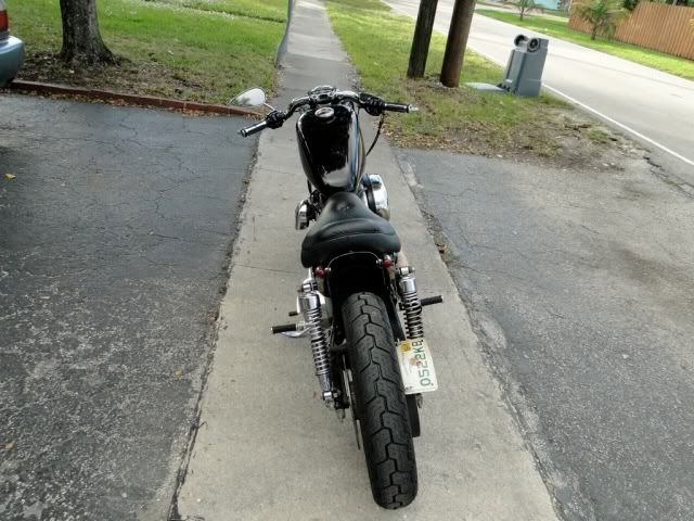

well Im still mapping my upgrades out but Im just wondering how the stance of the bike would be given it does have big tires, I want to go for a cafe look but I know obviously cafe racers don't have big front tires so I'm trying to picture my 48 with RSD clip ons/speedo relocator, Chainsickle rear sets, big 14.25 progressive shocks or 13.5 and Vance and hines competition 2 into 1 exhaust..
here was my previous build
2001 sporty 883
