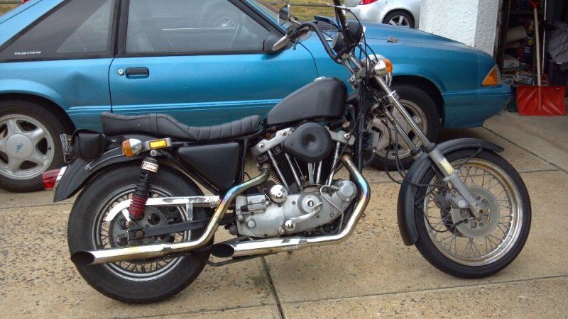

heres a pic of when i bought it are the long forks stock?

Those are overstock forks for sure. Mabye about 4 to 6 inches.
No you cant slide the tubes up on an Ironhead, the tops of the tubes are tapered and fit in a tapered hole in the top tree.
So you have to get them cut down and rethreaded by a machine shop. or buy new tubes.
Forking by Frank is the big name in quality tubes.

Looks like you have some good quality aftermarket shocks on the back, so would be better to go stock tubes on the front and have a nice handling bike.

How much longer were the FX's ?
2" or 4"?

The J&P catalog lists tube length for a 79 XL as 23 1/4 and the FXR as 25 1/4
