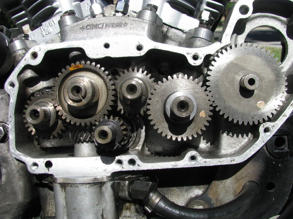

The position of the mark on the piniongear is all that matters - it doesn't matter if it's compression or exhaust stroke. The mark just needs to be at 11 o'clock and you line everything else up to that. Here's a pic of mine when I installed the cams, of course you don't have the generator gear...

Yep, looks like mine. I never messed with the push rods other than taking off and putting on the rocker boxes to get the cams in. Could they have gone out of whack that easily? Other than that, should the bike run with the timing in any position? The manual says to get the bike warmed up and idling at 1650-1950 rpm before adjusting timing. So if it doesn't start, how could you adjust it....

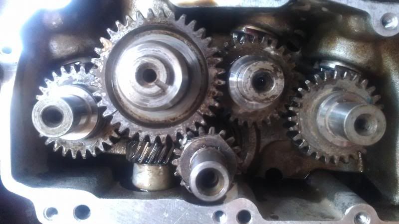

Alright. Checked rocker boxes and push rods are right, intake has small and exhaust has big. Why I put em back idk. HAHA. Popped my cam cover off and here's what I got. Granted...I couldn't get it lined up quite exact because of the cam pressure but it should be readable.
http://s138.photobucket.com/user/Jbr...tml?sort=4&o=0
I don't know how to post picture. Tried the add photo button, but it didn't function quite right. Just click the link and theres 4 pics to see.
OH YEAH! IXL2Relax... I tested compression and the rear cylinder a mere 60 lbs. Front cyl got about 100. This isn't looking good.

Just click on the IMG tag and paste it in yer text. Hit enter a couple times between each pic and you'll be golden...
