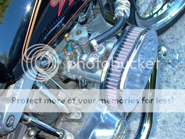

I had a big Weber DCOE 40 on my '78 for a while before switching to a smaller dual throat vintage Mikuni Solex carb. The Weber looked great and performed well but I had problems with the long manifold puddling gas a bit, resulting is some cylinder washdown problems.
The carb you're looking at will need a manifold, preferably one like in my photo to give your leg some additional clearance. These are big carbs and they take up some space. Also, quite a bit of tuning is necessary to get them to run right on each particular engine. Some parts can be hard to get as well. I've found that it's much easier to tune the Mikuni Solex than the Weber, even though I've been running Webers on my car for over 30 years.
Eric
My Weber Setup
My Mikuni Solex that I'm now running

the weber and the delorto are essentailly the same. these carbs were very common on 4 and 6 cyl cars in the 60's (Italian). I have tuned and run Weber carbs but I would agree with Eric regarding the pooling of gas, giant manifold, and they are just too much carb for a sportster...but what the hell...you can never have too much carb.....right?
