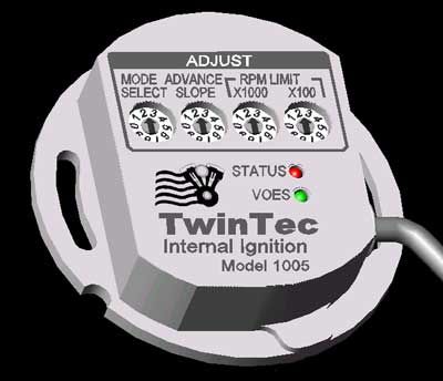

ive had this problem... your ignition module is going out. replace it with a stock one if you dont want any headaches.... also go ahead and delete the bank angle sensor while your at it... it usually craps out right after the ignition... just ground the green wire with the white stripe coming from the ignition to delete the bank angle sensor..

In all likelyhood its the module. The S/E replacement offers a higher rev limiter setting and a better ignition curve. You don't have to hit the limiter , but the improved curve is nice.

You were heating the ignition coil. The ignition module (behind the riveted cover) is the part that is prone to failure due to excessive heat inside the nose cone. Drill out the rivets with a small bit, then you can tap the holes and replace the rivets with small allen bolts or screws.
